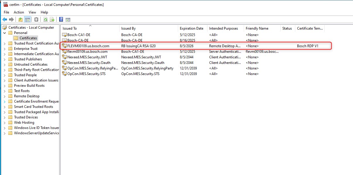

Workaround:
In order to workaround the issue and get the modules starting correctly:
  • Go to the option "manage computer certificates" and follow the path shown in the screenshot
  • manually remove the new RDP certificate (FQDN and intended purpose = Remote Desktop Authentication)
  • Restart the stuck services
The RDP certificate will automatically be added again after 90 minutes. This means the procedure needs to be repeated in case of service restarts or server restarts
