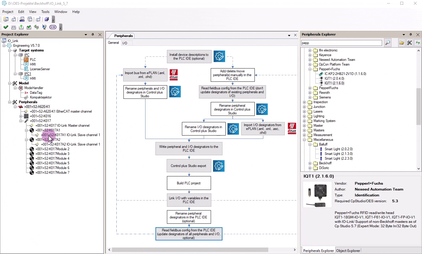

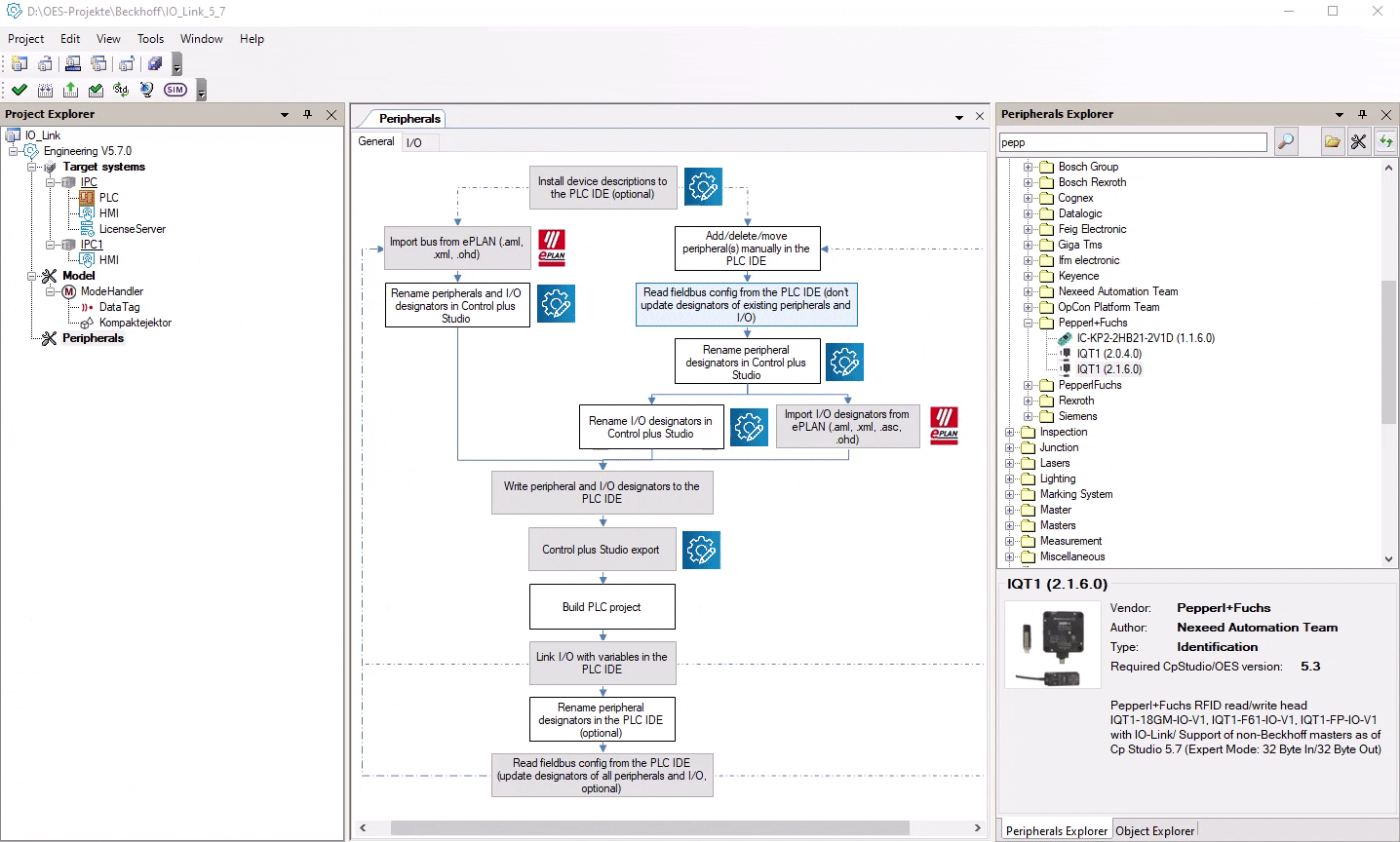

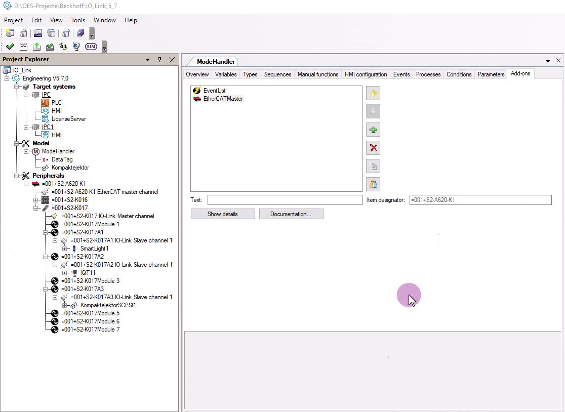

Add periphery to the new master type
IO-Link masters without IODD integration supply generic modules with a fixed byte length. Depending on the IO-Link slave, different modules can be connected to the master. The minimum data size required by the slave can be found in the object description of the IO-Link slave or in the manufacturer documentation.
The IO-Link slave peripheral object can be dragged and dropped onto the associated module of the IO-Link master.
Universal digital terminals
The generalization of IO-Link slaves in master devices without IODD integration enables the use of an universal peripheral object for digital inputs/output terminals. The same can be achieved by adding a generic slave to a master with IODD integration.
The number of input and output signals can be parameterized in the IO-Link slave periphery.
