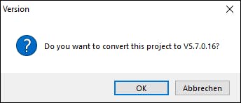

  1. Open the station project with the latest Control plus studio version.
    To be able to see the OpCon Engineering project in the file explorer, change the file type in the selection dialog to *.oep.
  2. After opening, a dialog appears asking whether the project should be converted.

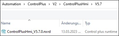

  3. The HMI runtime must be upgraded to the project version. To do this, select the NXRD file for the Control plus HMI. This can be downloaded via the Nexeed release server or via the download portal.

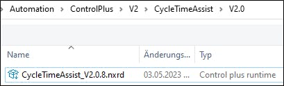

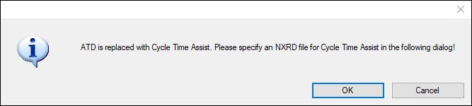

  4. The ATD app has been replaced by the Cycle Time assist with Control plus V2.
    The NXRD file for the Cycle Time assist must be selected for the update.

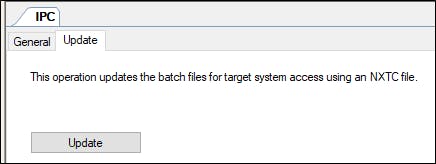

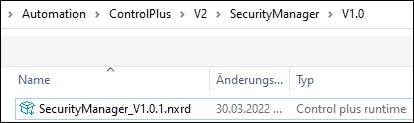

  6. The target content must be uploaded to the project version. To do this, select the NXTC file. This can be downloaded via the Nexeed release server or via the download portal.
  7. In Control plus V2, certificates are exchanged for communication between different services / systems, e.g. during deployment. This is handled by the Security Manager.
    • Add the Security Manager to the project.
    • To do this, select the corresponding NXRD file. This can be downloaded via the Nexeed Release

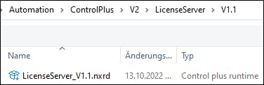

  8. The License Server is required to activate the Control plus licenses on the target system.
    • Add the License Server to the project.
    • To do this, select the corresponding NXRD file. This can be downloaded via the Nexeed release server or via the download portal.

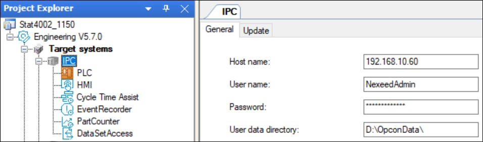

  9. Adjust the user information under the IPC settings.

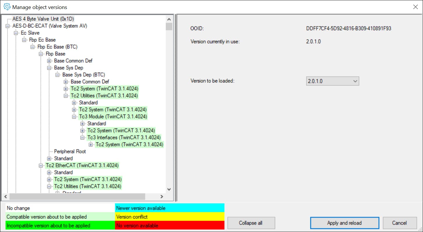

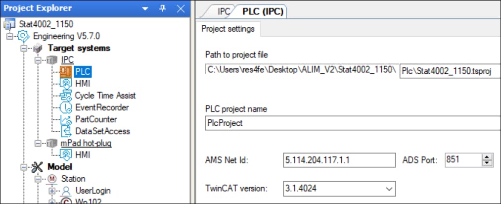

  10. Change the TwinCAT version to 3.1.4024 in the PLC settings of the TwinCAT runtime.
  11. The object versions for TwinCAT runtime libraries must also be upgraded to 3.1.4024. To do this, download the new versions using the Object Browser and then load them in the engineering project.

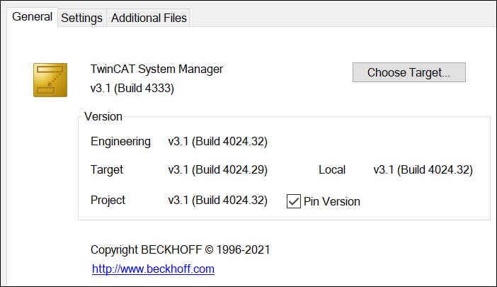

Settings in the TwinCAT project

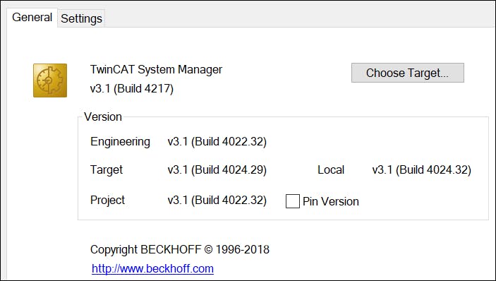

The TwinCAT runtime 4024 was introduced with Control plus V2, so the existing TwinCAT project must be converted.
  1. Select the menu item System and uncheck Pin Version.
  2. Then open a new TwinCAT instance (without an open project).
  3. Change the TwinCAT Runtime used in the Remote Manager.
  4. Then reopen the station project and check the Pin Version box again. The Engineering, Target and Project versions must now be identical for the first 4 digits.
-> The TwinCAT project has been converted and is ready to be downloaded to the hardware.

  3. Die HMI-Runtime muss auf die Projektversion hochgezogen werden. Hierzu die NXRD-Datei für die Control plus HMI auswählen. Diese kann über den Nexeed-Release Server bzw. über das Downloadportal heruntergeladen werden.
