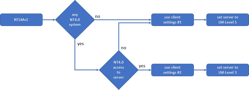

4. Nexeed Automation decision matrix
NTLMv2 decision matrix
Client settings #1
KeyValue
HKEY_LOCAL_MACHINE\SYSTEM\CurrentControlSet\Services\LanmanWorkstation\Parameters\EnableSecuritySignature
1
HKEY_LOCAL_MACHINE\SYSTEM\CurrentControlSet\Services\LanmanServer\Parameters\EnableSecuritySignature
1
HKEY_LOCAL_MACHINE\SYSTEM\CurrentControlSet\Control\Lsa\lmcompatibilitylevel
3
Client settings #2
KeyValue
0
1
1

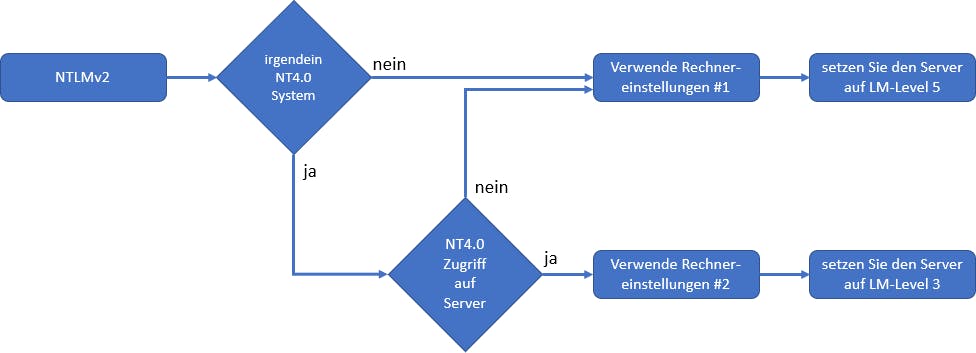

4. Nexeed Automation Entscheidungsmatrix
NTLMv2 Entscheidungsmatrix
Rechnereinstellungen #1
SchlüsselWert
1
1
3
Rechnereinstellungen #2
SchlüsselWert
0
1
1
