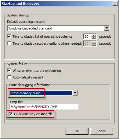

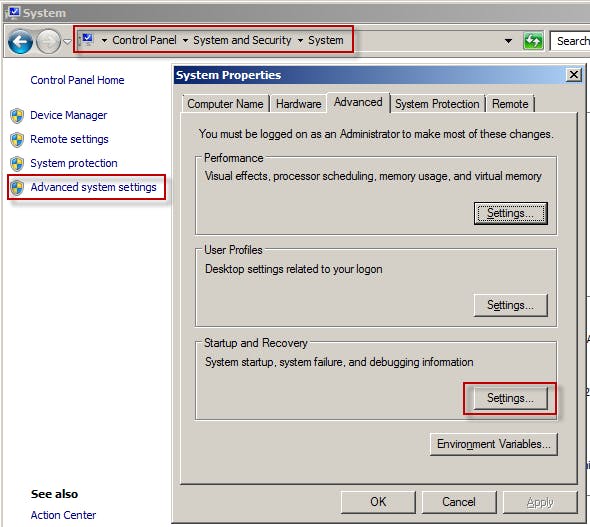

  1. Open the startup and recovery settings on the target system:
    Control Panel > System and Security > System Advanced system settings > Advanced > Startup and Recovery Settings
  2. Select the option kernel memory dump and activate the checkbox for overwriting existing files:
  3. Close the dialog with OK.

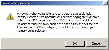

    Do you get following error?
    Only if you get this error:

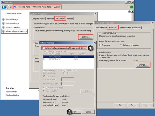

    Open the virtual memory settings on the target system:
    Control Panel > System and Security > System > Advanced system settings > Advanced > Performance Settings > Advanced > Change virtual memory
    Then activate the checkbox to automatically manage paging file size for all drives, acknowledge all dialogs with OK and restart Windows.

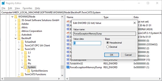

  4. This step is only necessary if you do not get a dump file (MEMORY.DMP), for example in case of an exception without call stack:
    Add following registry key as DWORD (32-bit) with value 1 in the Registry Editor on the target system:
    HKEY_LOCAL_MACHINE\SOFTWARE\Wow6432Node\Beckhoff\TwinCAT3\System\ForceExceptionMemoryDump
    Attention: This registry key causes a system crash instead of a page fault exception. After analyzation you must reset this key to 0 or delete it.

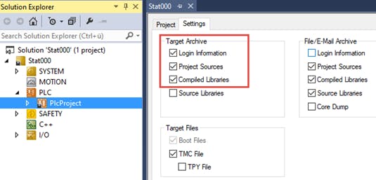

  8. Copy the whole content of the TwinCAT boot folder from the target system:
    C:\TwinCAT\3.1\Boot\
    It usually contains a copy of the PLC project if you have used the Control plus default settings in TwinCAT:

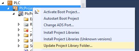

  9. If your TwinCAT version provides following update function execute it on your development system:

  1. Auf dem Zielsystem die Startup and recovery settings öffnen:
  2. Die Option Kernel memory dump auswählen und das Häkchen zum Überschreiben existierender Dateien aktivieren:
  3. Den Dialog mit OK schließen.
    Erscheint folgender Fehler?
    Nur wenn Sie diesen Fehler erhalten:
    Auf dem Zielsystem die Virtual memory settings öffnen:
    Dann das Häkchen Automatically manage paging file size for all drives aktivieren, alle Dialoge mit OK bestätigen und Windows neustarten.
  4. Dieser Schritt ist nur notwendig, wenn man keine Dump-Datei (MEMORY.DMP) erhält, z.B. im Fall einer Exception ohne Call Stack:
    Folgenden Registry-Eintrag als DWORD (32-bit) mit Wert 1 im Registry Editor auf dem Zielsystem hinzufügen:
    Achtung: Dieser Registry-Eintrag verursacht einen Systemabsturz anstatt einer Page Fault Exception. Nach der Analyse sollte der Eintrag auf 0 zurückgesetzt oder gelöscht werden.

  8. Den vollständigen TwinCAT-Boot-Ordner vom Zielsystem kopieren:
    Üblicherweise enthält er eine Kopie des SPS-Projekts, wenn die Control plus Standardeinstellungen in TwinCAT gesetzt sind:
  9. Wenn Ihre TwinCAT-Version folgende Update-Funktion enthält, diese auf dem Entwicklungssystem ausführen:
