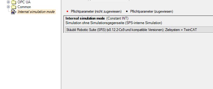

I want to do a robot simulation with SRS and Twincat.
In the parameters-section of the robot-simulation-peripheral I found a parameter to switch to simulation with SRS:
What do I need on my system to do such a simulation?

I am not the expert for this solution but I can give you some basically informations :
- You need your local beckhoff runtime with installed TF6100 OPC UA package
- You need the SRS with a running Emulator for your Robot and activated OPC UA license
In emulator mode, the SRS mapps the EtherCat I/Os to the Stäubli OPC UA Server
and the simulation peripheral connects to this Stäubli OPC UA server as a OPC UA Clinet .
To get the connection to the Stäubli OPC UA server to work,
you have to create a certificate - for which stäubli provides a SSL generator.
For more details , you can take a look In the documentation of our simulation peripheral,
there the necessary steps are described...
