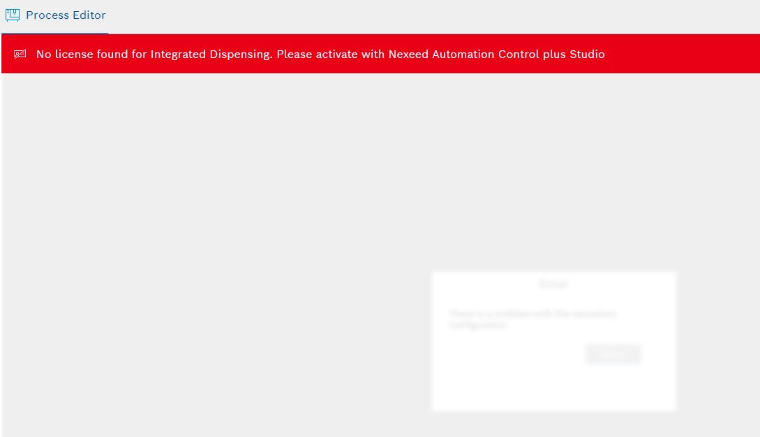

I am using the Process Editor for the first time, and when opening the HMI add-on page, it issues an error regarding a license detection failure, as described in the image below.
We have ordered the IntegratedDispensing dongle and it is already plugged into the PLC.

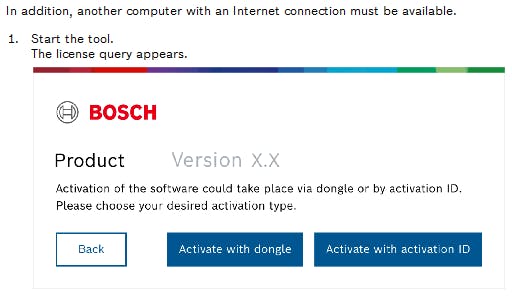

I have also searched in the documentation, and it mentions an activation "tool", which I'm not informed about.
I think there's something to do with this step. Where can I find this referred tool?

IntegratedDispensing you activate with Control plus studio.
This information is not in the english documentation. Sorry for the mistake. We change this as soon as posible.
One quastion i have. What do you mean with dongle is pluged in? If you ordered IntegratedDispensing license, only Activation ID send to you. Activation on the Bosch dongel (Control plus V2 license dongle) you make directly on the station with CPS.
