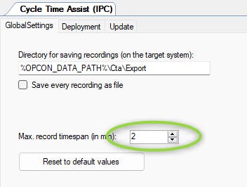

The CTA settings in CpStudio allow to configure the maximum record duration:
After changing the settings, you need to export and deploy the CTA configuration.
