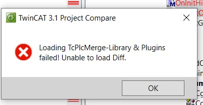

After I select the path for both versions, I get the error: " PlugIn-Initialization failed!"
I hint enter in order to continue the comparation. You can see the number of additions, deletions, and logical differences , but when you really want to see the information from inside, it says that " Loading TcPlcMerge-Library & Plugins failed! Unable to load the Diff."
If you have installed TwinCAT 3.1.4022.27, you should install a newer version to update the Project Compare Tool (e.g. 4022.32).
For your project you could still use 3.1.4022.27.
