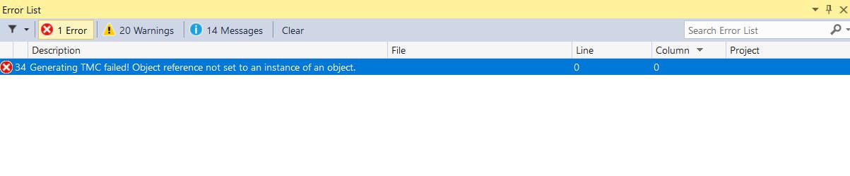

  One issue I have, after I build PLC program, one error is occurred, 'Generating TMC failed! Object reference not set to an instance of an object'.
PS: The program is running in the production line, and build it without error in the owner computer, but others' computer has this error.

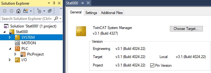

Make sure that the "pin version" checkbox is set. Otherwise the project will open with different TwinCAT versions depending on what is installed on your computer.

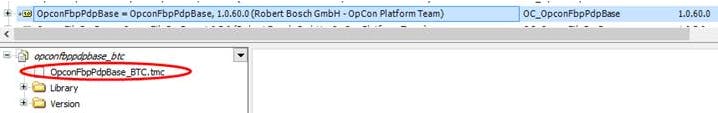

  4. Delete the TMC file in TwinCAT and compile the PLC project (which should re-create the TMC file):
    Hint: If creation of the TMC file still fails, your IO links will be lost after closing TwinCAT.
  5. If you still could not solve it:
    Other libraries could be the causer (usually not the Bosch Connected Industry libraries).
    1. Check for libraries that inlcude a TMC file (which should not be included in libraries):

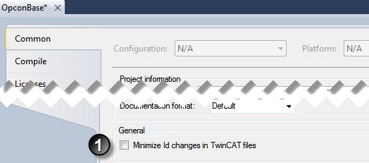

    2. The library creator must set and afterwards remove the checkbox "Minimize Id changes in TwinCAT files" (1). Then the creator must create a new library version:

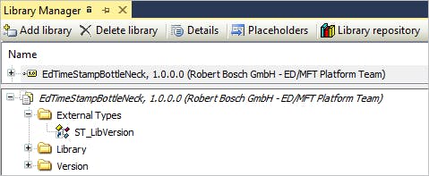

  6. If the error message is "Generating TMC failed! Value cannot be null. Parameter name: source" then you have to check all referenced libraries for unnecessary external types like ST_LibVersion. In the following library EdTimeStampBottleNeck by Bosch ED/MFT (BueP) this was the case:
