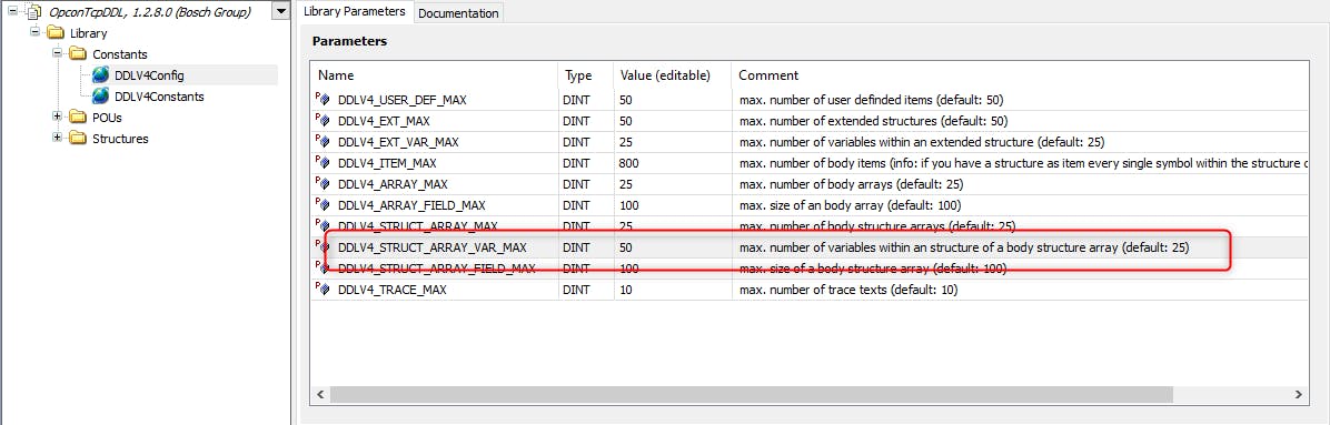

is it posibile to change the OpconTcpDDL.DDLV4Config.DDLV4_STRUCT_ARRAY_VAR_MAX from default value 25 to 50?
ย
With the MES@AE Objects this value must be change for every plc program, and also after updating the Library!
It would make our work much easier if the value was set to 50 by default.

In general, we try to avoid changing library parameters, because every project updating to the new version needs to execute Clean and Activate configuration afterwards. Otherwise page faults might occur. For users not needing the updated constant, this is annoying.
Nevertheless I have good news: In this case, where a high number of projects is suffering from the insufficient default value, we have decided to change the parameter. A new version of the library will be published in a few weeks.
