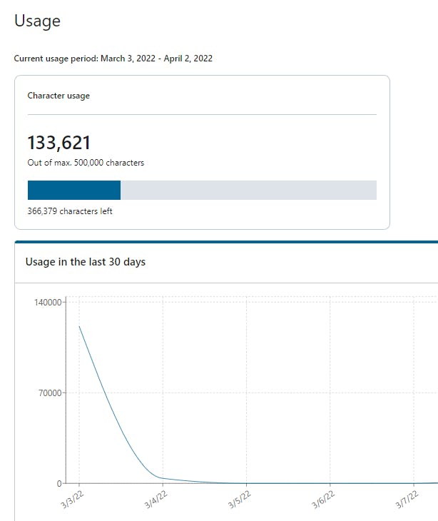

DeepL API
With Free plan access to API you can translated 500 000 characters in a month which is enough for this task. Unfortunatelly you have to fill your credit card information during the registration, even though you won't be charged any fees.
