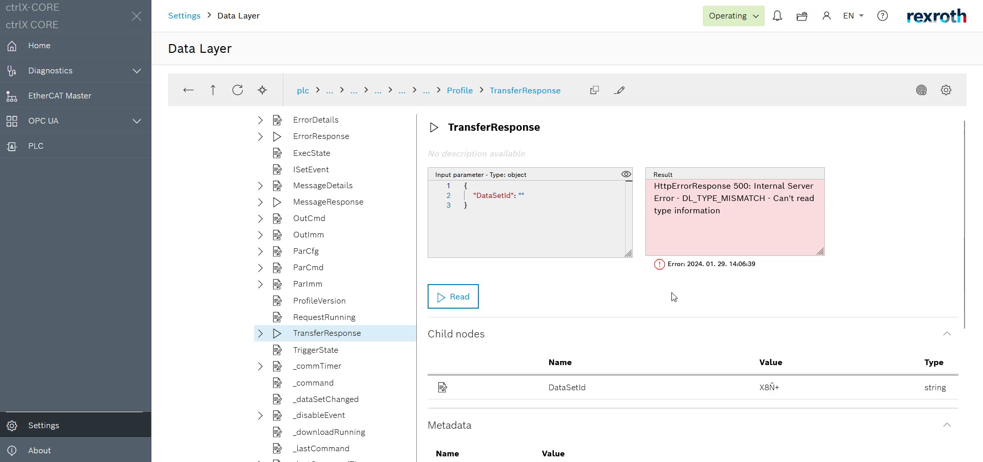

Is there any idea someone why the nexeed doesn't able to run the transferresponse method?

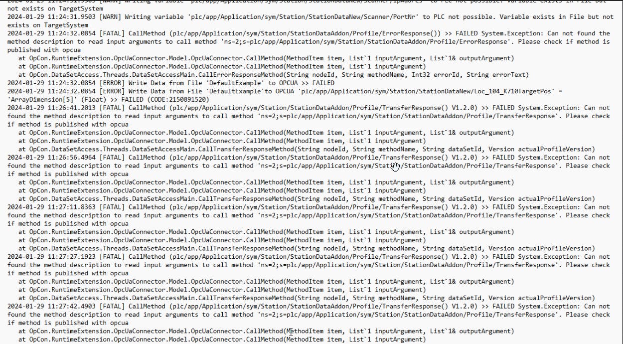

The log file shows this problem:
However in the PLC datalayer I can se this method.
Can anyone met this kind of problem?

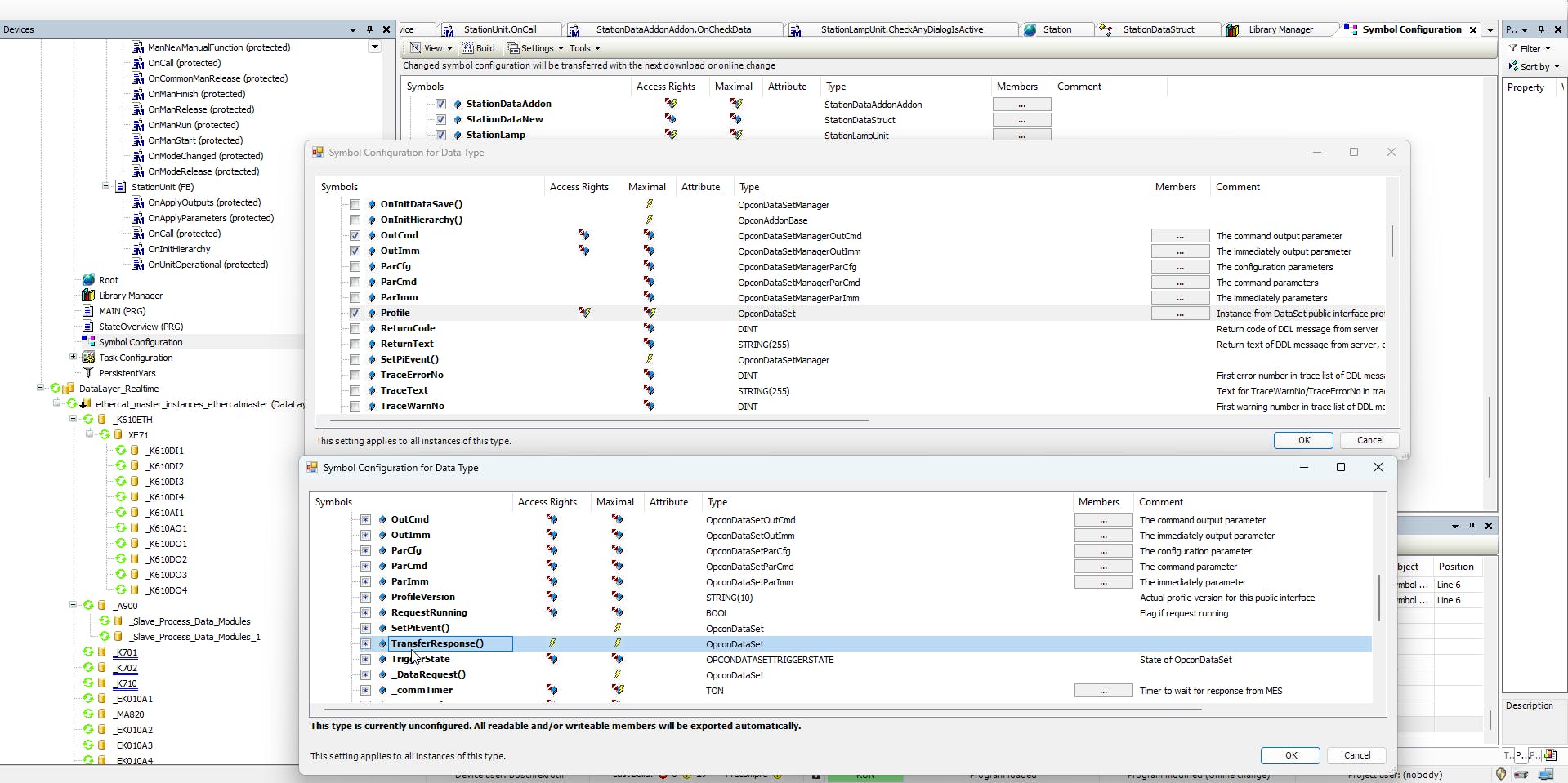

The PLC program also contained this TransferResponse method:
This is a fresh control plus studio export with nothing modification.
The  "Support OPC UA features" and "Support calls to Functions..."  are set.
