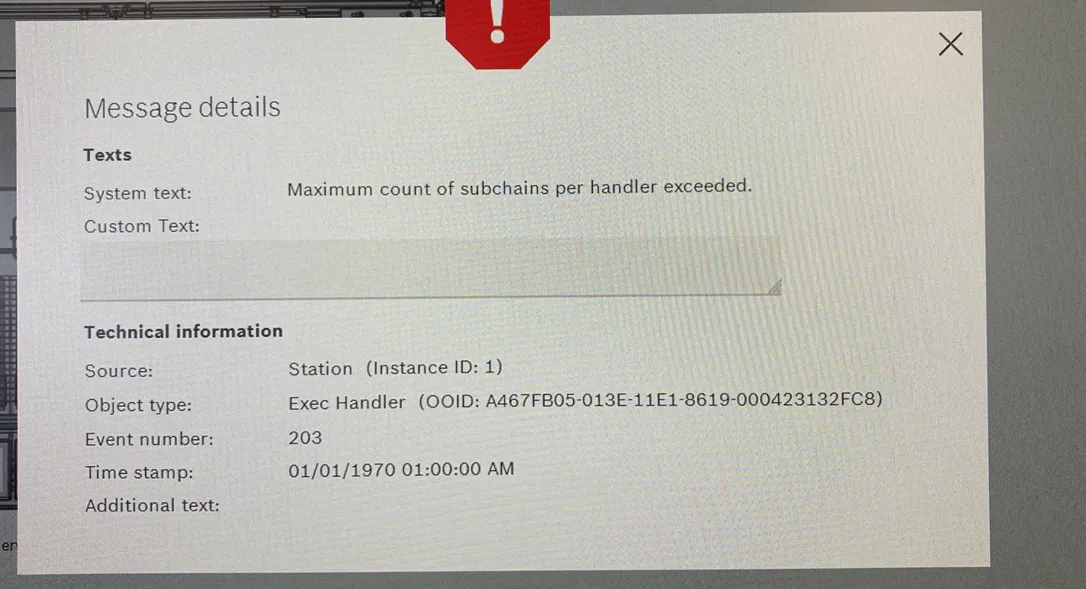

Is there a way that I can have more Sub Chains please? If I add many Sub Chains (e.g. to Station Mode Handler) I get the error shown in the photo below.
What are the maximum Sub-Chain limits please?ย  e.g.
- 10 Sub Chains per Mode Handler ?
- 10 Sub Chains per Command Handler?
Many thanks! ๐Ÿ˜Š

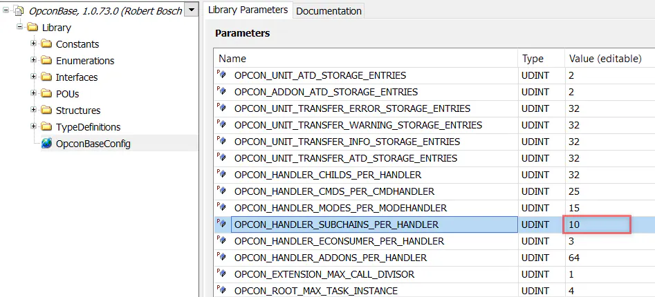

Best reply by Hbszjjw
you can change it in OpconBaseConfig in OpconBase library, the default value is 10, after change it, you should do "Clean Solution" -> "Rebulid Solution" and login to make it effective.
