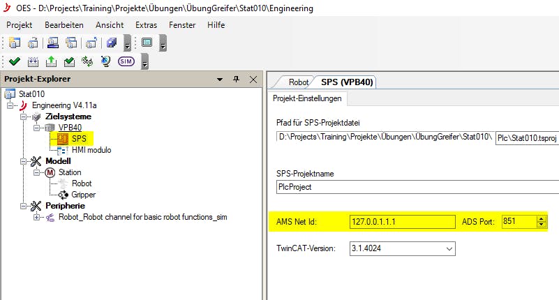

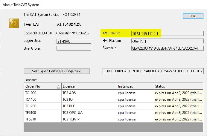

Did you check the AMS Net ID and ADS Port in your configuration ?
The configuration must match to your PLC target system :
For a local running PLC - you can use 127.0.0.1.1.1 as  AMS Net ID.

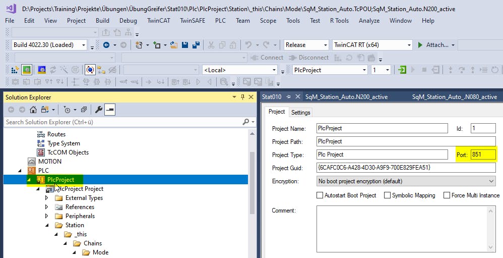

You can find the used ADS Port in your PLC project :

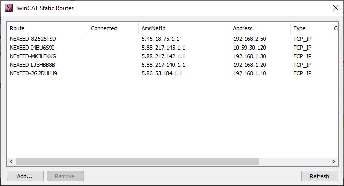

If you want to connect to a PLC on a remote IPC,
you also must have a valid route to the target system :
