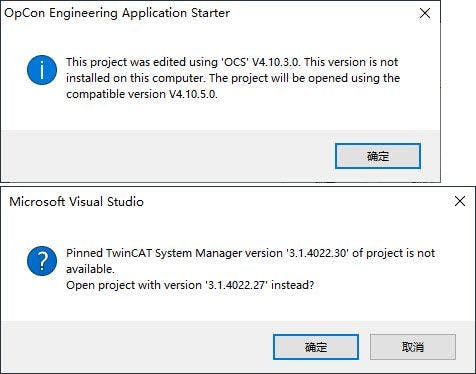

I currently have a project file whose OES version is 4.10.3, and the TwinCAT program version is 4022.30,
but the OES version in my computer is 4.10.5 and the TwinCAT version is 4022.27.
If I want to open this project normally, I need to Does the version have to be the same as the project program version?
Does the OES version just need to be 4.10, or does it have to be exactly the same?

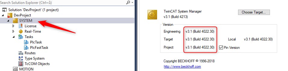

You should not update TwinCAT version. Version in your computer has to be always the same as version of runtime on the target. So probably version of your runtime at PLC is 4022.27 and you should use same version at your computer. I remember if I updated my project to different version then the runtime version on the target, sometimes it was working fine, but sometimes there was some strange behaviour, like random exceptions, non functional usage of breakpoints and other issues. All versions should always be consistent, see image. Another solution is to update runtime version on the target.
As Düscha wrote, just install correct Remote manager. It is file with RM postfix, not the FULL installation. For your case it is here \\bosch.com\dfsrb\DfsDE\DIV\BCI\Nexeed\Automation\ControlPlus\Common\TwinCAT3\4022.27\TC31-RM-Setup.3.1.4022.27.exe. It does not reinstall your TwinCAT, but it only adds right version into your current installation. See my TwinCAT screenshot.
