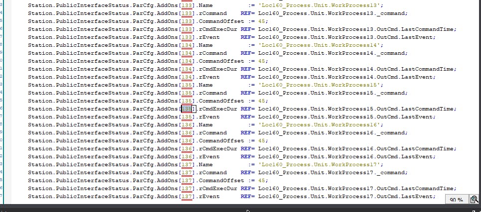

I have a project with OPC UA MES connection. I want to use the public interface status addons to get diagnose in error state.
Unfortunately I have more than 128 opc ua addons in my project.
After export I get error messages because the array idx is higher than maximum.
Is it possible to change the size of the array with an editable constant?
