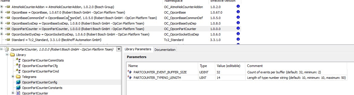

With the  older version of APP (.ord file), I can able to change the TypeNo lenth from default 10digit to 14digit in the PartCounter library and it was working fine till date.

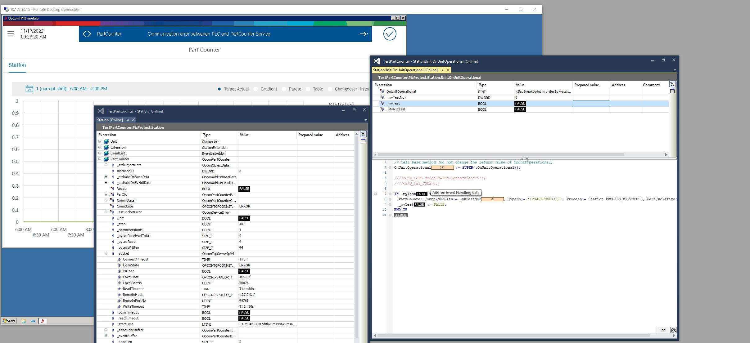

But in the newer version (ord -1.5.5.5), If i use only 10digit typelength its working but if i increase then i get the following error "Communication Error between PLC and PartCounterService". As per the comment mentioned in library i can use the TypeLen between 10 to 50, right?
Attached picture is for your reference. Thankyou 🙂
