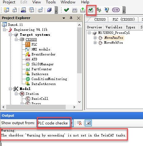

When I execute check PLC project in OES, the following warning occurs, what should I do?
I think what should be set in TwinCAT3, but I don't know.
Thanks!
Warning:

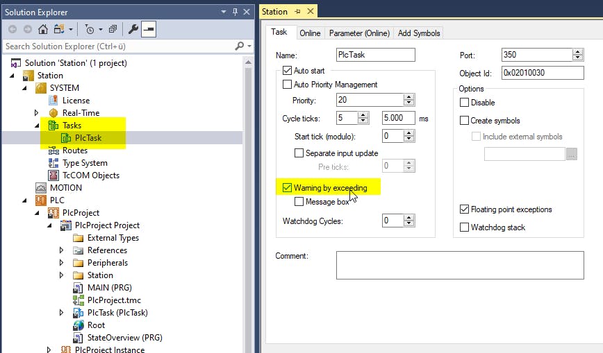

The checkbox 'Warning by exceeding' is not set in the TwinCAT tasks.

As described in the warning, it is recommended to activate the setting "Warning by exeeding" in the TwinCat tasks.
