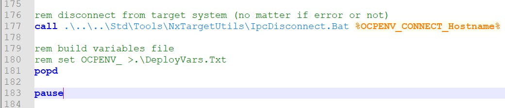

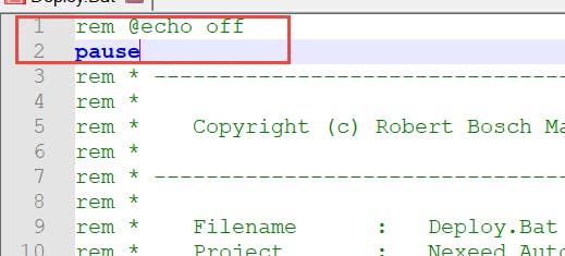

In order to find out where the problem is occuring, please switch on the output in Stat010\Targets\Deploy.bat, i.e. comment out the first line with rem and add a pause command in line two and at the end of the file (see screenshot).
Now, the Deployment window will wait for input before it closes and we should get some more information.
