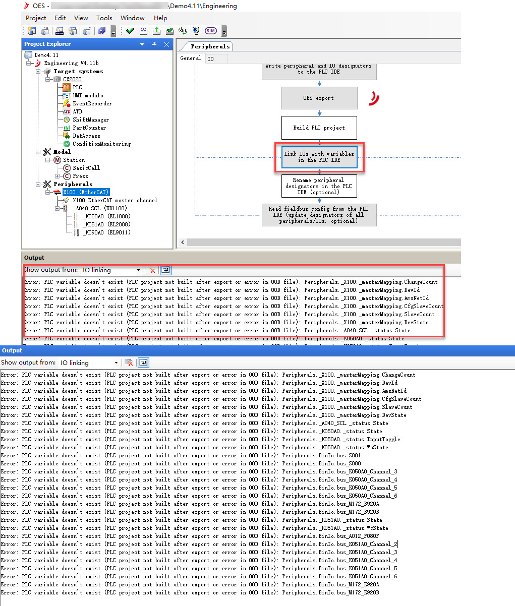

OES 4.11 / Link IO with Variables in the PLC ide reports an error at this step
TwinCAT3 runtime version is 4022.27.
OES version is 4.11.b.
It seems to be an error in the ood file, but my Objects and Peripherals files are downloaded from your official website, I don't know why, please help me to find out what the problem is,

Never had a problem like this with the EtherCAT master, I believe. Like the error message indicates, did you build your project in TwinCAT and was it successful (no errors)?
