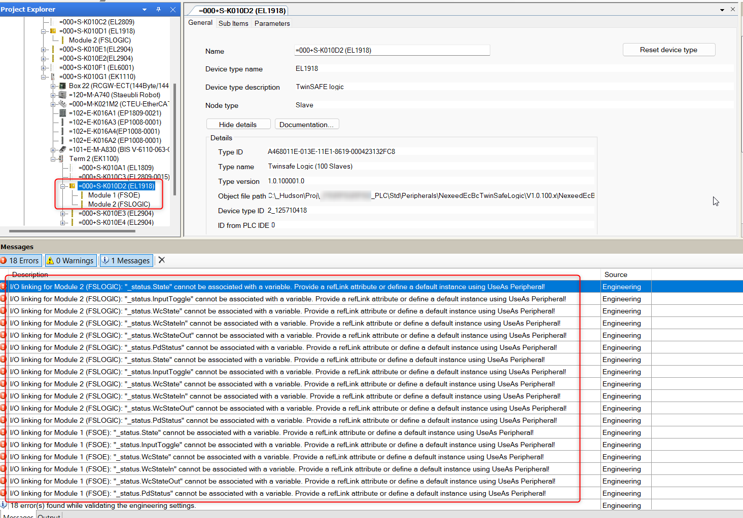

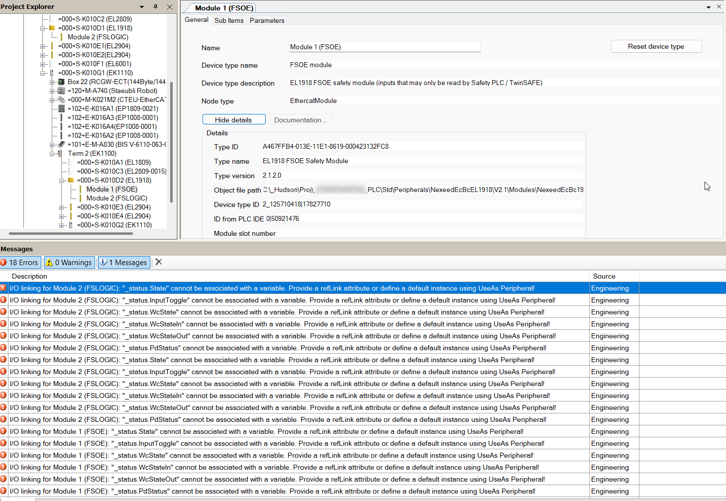

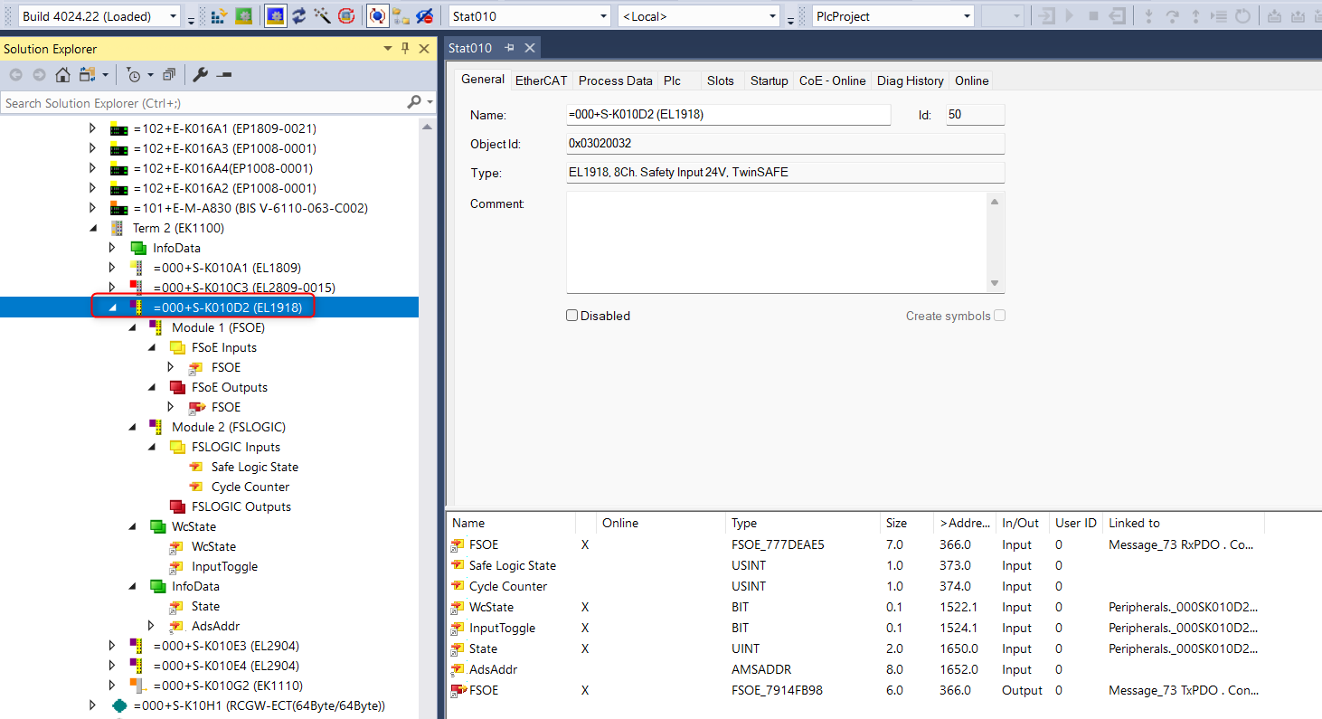

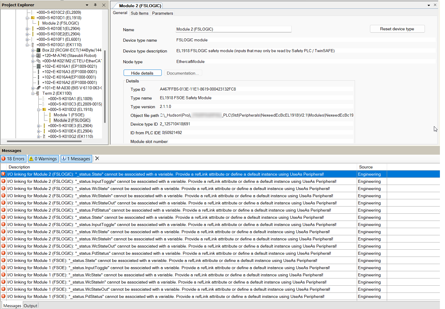

After the object EL1918 of Beckhoff is scanned from the TwinCAT, the CPS has several errors, I do not understand what it is meaning. Please see the attachments, thank you~
NexeedEcBcEL1918 - V2.1
NexeedEcBcTwinSafeLogic
CPS5.4
CPS5.4
NexeedEcBcEL1918 V2.1 should not be used anymore (although it is currently the latest version).
If you use the EL1918 just as an input terminal, use NexeedEcBcEL1918 V2.0.
If you use the EL1918 as TwinSAFE logic terminal (instead of EL6910 / EL6900), use NexeedEcBcTwinSafeLogic peripheral (without NexeedEcBcEL1918 V2.1).
