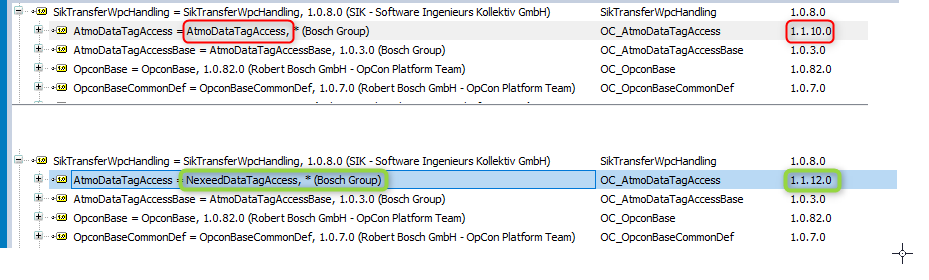

The reasons, why you get an exeption is, because you referenced the wrong library in your  library.
You Referenced the Library AtmoDataTagAccess but you need the Library NexeedDataTagAccess.
The HMI is not filled, because you referenced your chain to _outCmd and you give OutCmd to the HMI. These are 2 different variables.
