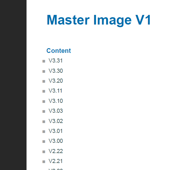

I have to update the Nexeed Image on a service stick from  V1 2.20 to 2.22.
If I use the ServiceStick V3.0 from Nexeed , how does it work, can I selecet which version I want to install or all the versions listed in the Master_Image_V1_V3.31 file (check the attached picture) will be installed ?
The idea is that we want to return to the old version of 2.20, is it possible to downgrade ?

Sorry, the release notes are a little bit confusing, we are working on it ....
If you are downloading Control plus/V1/Service Stick/V3.0 and update your stick, you will get :
Nexeed Image Rexroth VPB40.3V2.2215.09.2021Nexeed Image Rexroth VPB40.4V2.2215.09.2021Nexeed Image Beckhoff CX2020V2.2215.09.2021Nexeed Image Beckhoff C6930V2.2215.09.2021Nexeed Image Bosch mPadV2.2016.05.2019   Nexeed Image Rexroth VPB40.3V3.3023.03.2020Nexeed Image Rexroth VPB40.4V3.3023.03.2020Nexeed Image Beckhoff CX2020V3.3023.03.2020Nexeed Image Beckhoff C6930V3.3023.03.2020Nexeed Image Beckhoff C6015V3.3112.11.2020Nexeed Image Bosch mPadV3.3023.03.2020Nexeed Image Rexroth VEPxx.6V3.3023.03.2020Nexeed Image Beckhoff CPx7xxV3.3023.03.2020
The Image tool provides a drop down box to choose between V3.x (default selection) and V2.x Image :
The V2.20 Image is only available for the mPad.
