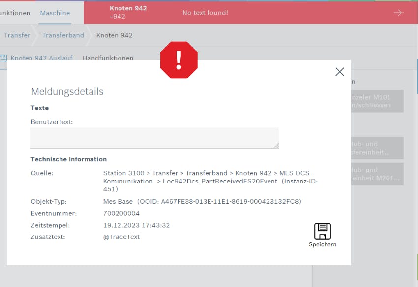

I found different Eventnummers from the MES, which are not implementet at the NxMesBase.
Is it also possible to write Nexeed Mes Base or Nexeed DDL Event Base instead of MES Base in Objettype! With the naming MES Base it is not clear which “base” we are talking about here. And very often we get feedback from the MES@AE team that there are missing error texts. But unfortunately there is nothing we can do here.
I would be very happy if the exchange of error numbers between Nexeed MES and the automation team were optimized.
Secondly, it would help us if the name "MES Base" wasn't just used.
Thanks alot!
This error does not come from MES but directly from the DDL message FB. And the text is not missing. I can see it in your screenshot.
