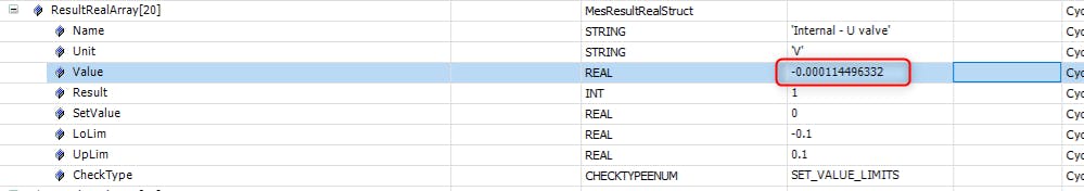

Missing digits in PartProcessed REAL value
After sending REAL value with more decimal places as a part of PartProcessed, some digits are missing and instead of them there is an invalid chaacter in the XML. See images.
We fixed the problem temporarily using rounding of the REAL value to less decimal places.
Rounding the REAL value is the correct solution, see our customer information from Mai 2021 below. The problem is caused by REAL_TO_STRING / LREAL_TO_STRING.
Beckhoff provides a nice function LREAL_TO_FMTSTR in the Tc2_Utilities library to round a floating number.
