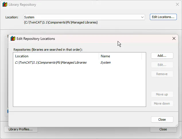

What is the best way to handle all these libraries version differences, to avoid loading the project with a different library version than the one from the project STD? Does it bring any help, to use multiple libraries locations, to have a better control over the libraries version? (see picture below)
What should we do before passing the program to the client, so we are sure that they can go online, without the request to download or online change the program? Should we empty the Managed Libraries folder before, export and load the program, so we don't have any interferences caused by the local Managed Libraries folder.

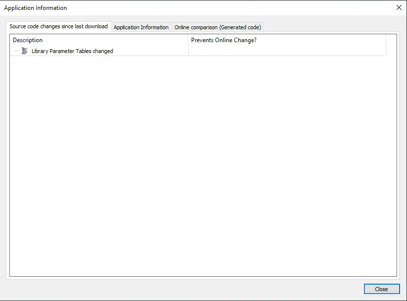

Most of the time we have the following difference, when we try to connect from a different machine. (see picture below)
