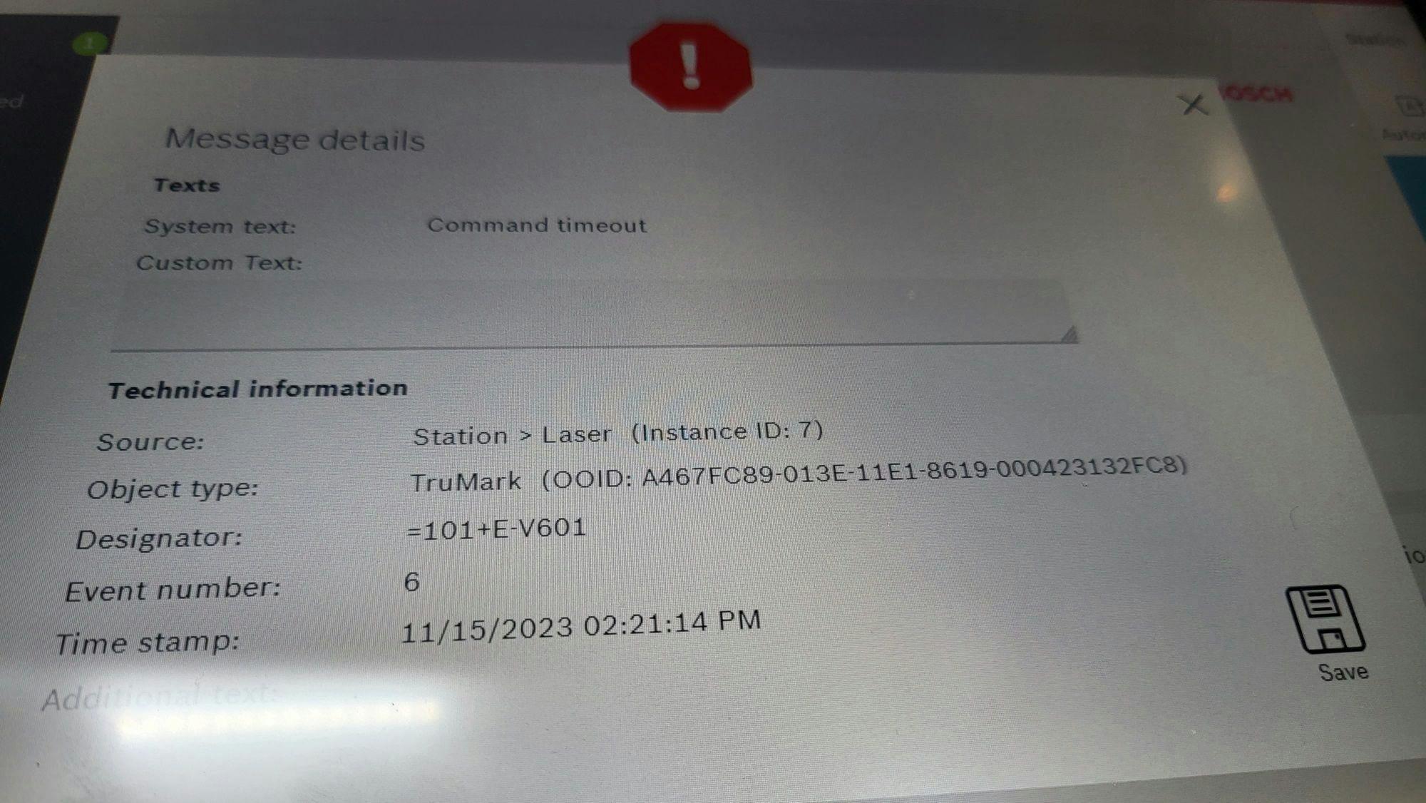

I have a problem that we have built several times the same machine with the trumpf laser. On some machines the "Turn off" button works and on others it does not work.
Laser: Trumpf TruMark 3000 (Lasers are used older and rebuilt with new PC + EtherCAT card)
Peripheries: TruMark (1.1.12.0)
Object: Marking Laser (1.1.10.0)
The error will manifest itself as follows:
1)  Loc101V601_Laser.Unit.Command := MarkingLaserTrumpfCmd.LASER_OFF; Loc101V601_Laser.Unit.Execute := TRUE;
2) Laser receives no TLV command
3) Plc reports "Command timeout" error
All other commands work without problems.
Unfortunately I don't have the library source files to check why the TLV command is not being sent. Can someone please advise me what could be the error?
