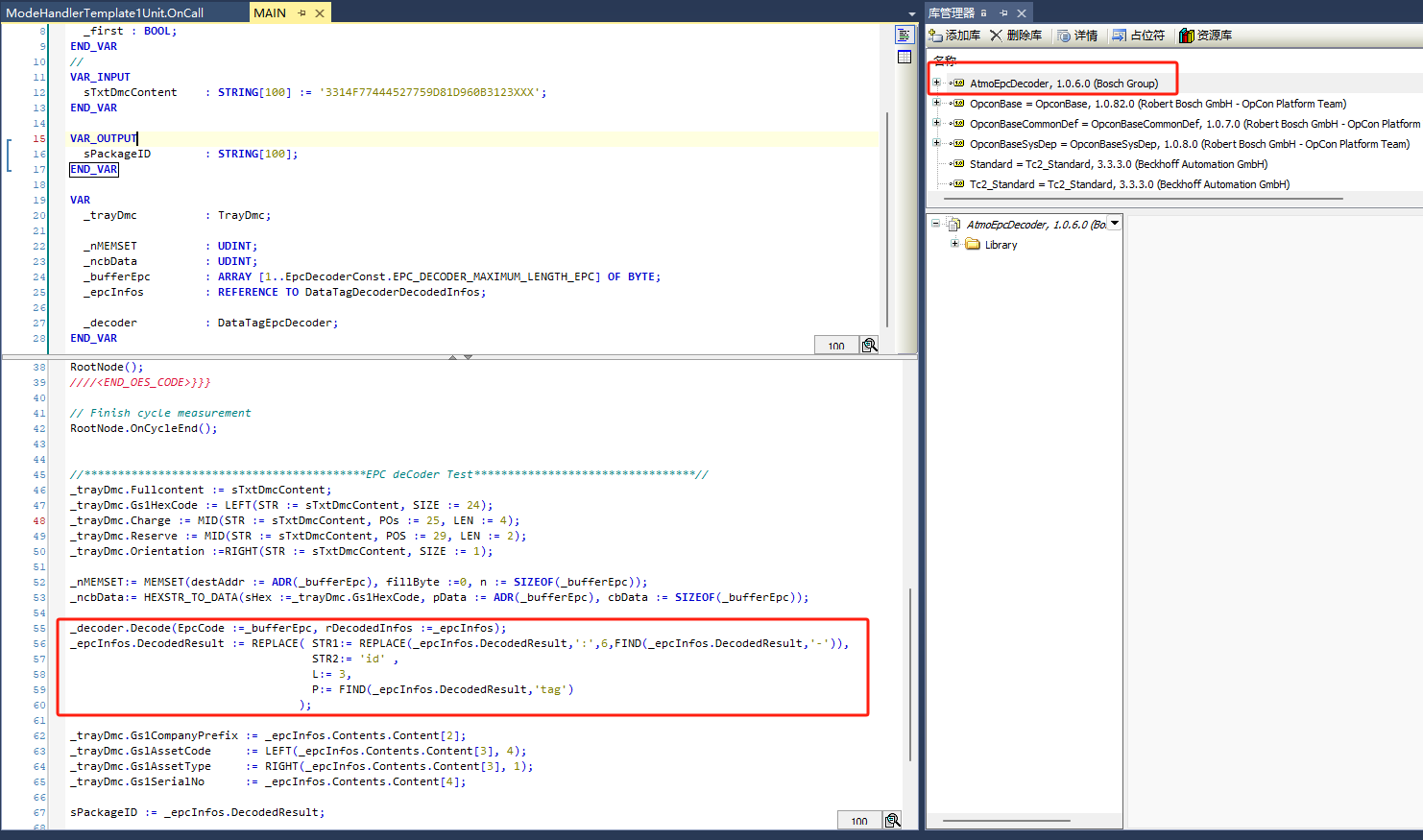

Hi guys,Does anyone have used the <AtmoEpcDecoder> object for a DMC decoding?I  did some test program for testing this lib,but when I simulated,some errors in TwinCAT system occured, I dont konw wether I use it in a wrong way. If you have some experience, please share it to me.thank you.

Looks like a simple mistake :
You have defined your "_epcInfos" variable as "REFERENCE TO DataTagDecoderDecodedInfos" , but you never set the reference to valid variable.
Either you have to assign the reference to valid variable :
_epcInfos  REF= YourEpcInfosInstance;
or you change the data type :
_epcInfos : DataTagDecoderDecodedInfos;   instead of  _epcInfos : REFERENCE TO DataTagDecoderDecodedInfos;
