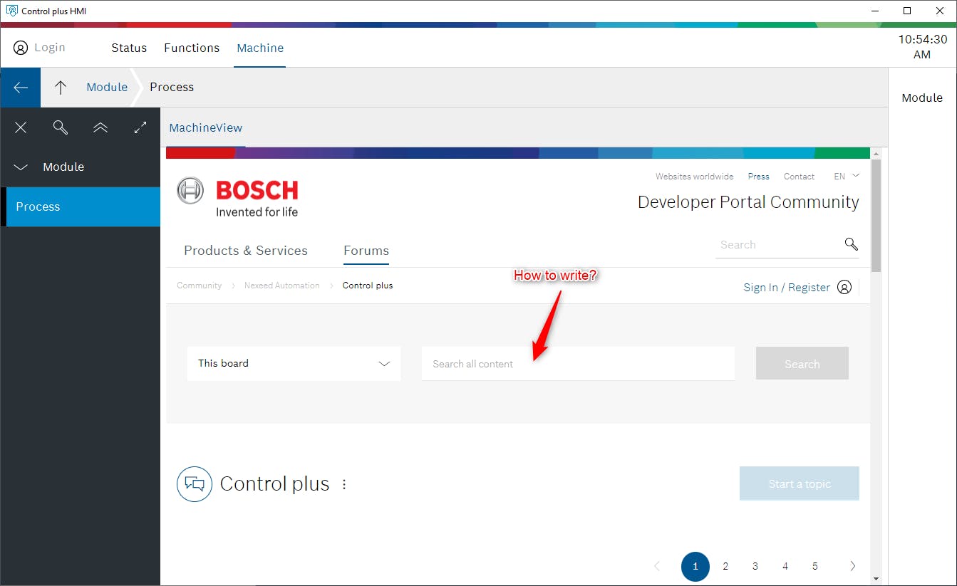

Currently I am working in a view where I have a Mod_HtmlView with a specfic url.
The problem appears when I have to write something in the web showed in that view. The Virtual Keyboard doesn't appears.
Is there any solution to be able to write in these views?

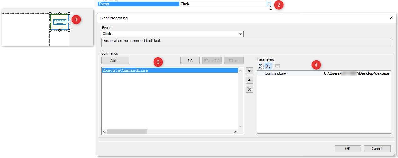

I found a solution opening the windows keyboard from a Command Line but I am not able to open the windows keyboard of the default windows folder.
I had to copy the .exe file to Desktop and now it works.

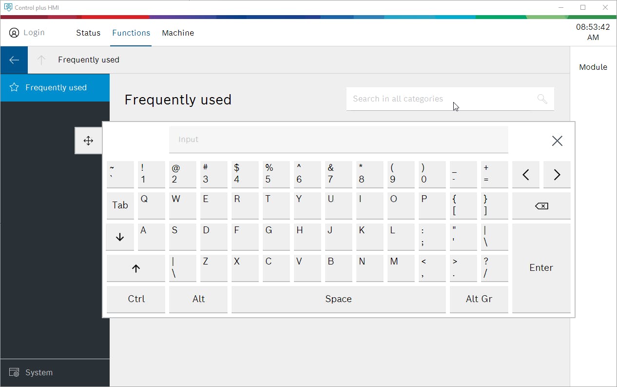

I dont know if there is a better solution opening the Nexeed Keyboard like the following picture that appears automatically when clicking:
