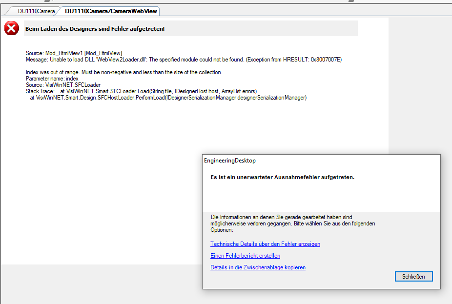

I'm using CPS 5.8 and I wanted to open a HMI view which contains an HtmlView. As soon as it loads, CPS shows an error (please see attachment) that I'm missing the WebViewLoader2.dll file. I've tried to reinstall CPS, also reinstalled Microsoft Edge, separately reinstalled Microsoft WebView 2. Also tried to install it with Evergreen, and additionally I got the dll file and copied under System32.
Nothing solved this issue, and my colleagues doesn't have this problem with the same settings and same project.
Could you please give me some advice?
