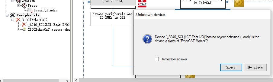

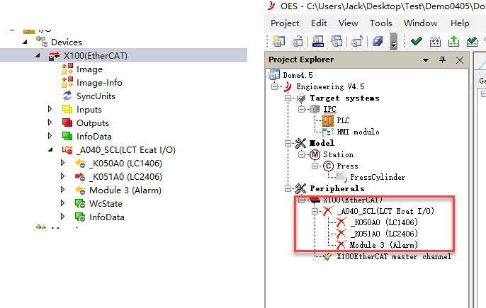

I have an EtherCAT coupler from another brand here (similar to  the BECKHOFF EK1100),
but it's not in the STD/Peripherals catalog, and I hope it's available in OES.
I have tested that its configuration in TWINCAT3 is ok and can be used normally.

After repeated testing and communication, it is confirmed that this module cannot be used in Nexeed.
because the physical communication level of this module is completely different from Beckhoff,
so even if you add it in OES, it cannot be used, because OES The OpconFbpEcBase will be loaded automatically, and then an OCEC-related error will appear.
