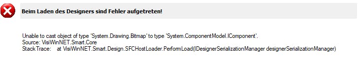

When exporting the project for the first time, I'm getting an error prompt, providing information on some errors that occurred during the process (shown below).
Also, after creating and opening an HMI view, I'm also getting an error message (shown below).
Am I missing some steps upon creating the project?
Thank you in advance for your help.
  1. Your HMI error occurs if the folder Hmi_V5_x is missing in the Std folder or has the wrong version number (e.g. Hmi_V5_3 instead of Hmi_V5_8 for Control plus Studio V5.8). Add an HMI to your target system in Control plus Studio and select the correct HMI NXRD file (same version V5.x like Control plus Studio).
  2. Exporting a new project without bus works without export error. It also works after adding "Simulation Basic Move".
    According to the HMI problem I assume your Std is corrupt/inconsistent.
