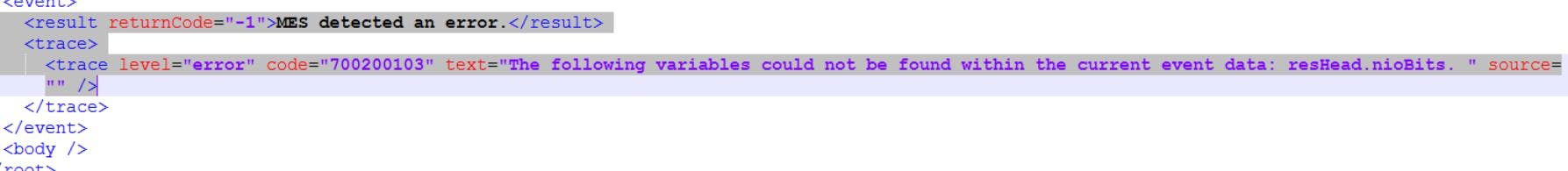

content of MES telegram :
<result returnCode="-1">MES detected an error.</result>
<trace>
<trace level="error" code="700200103" text="The following variables could not be found within the current event data: resHead.nioBits. " source="" />
The reason why is this error appear is because the value sent by PLC for Global  NIO bit is "2147483648", where as MES expects the max value only until "2147483647" (Tested), for the data type DINT, everything is as per standards in PLC and MES.
