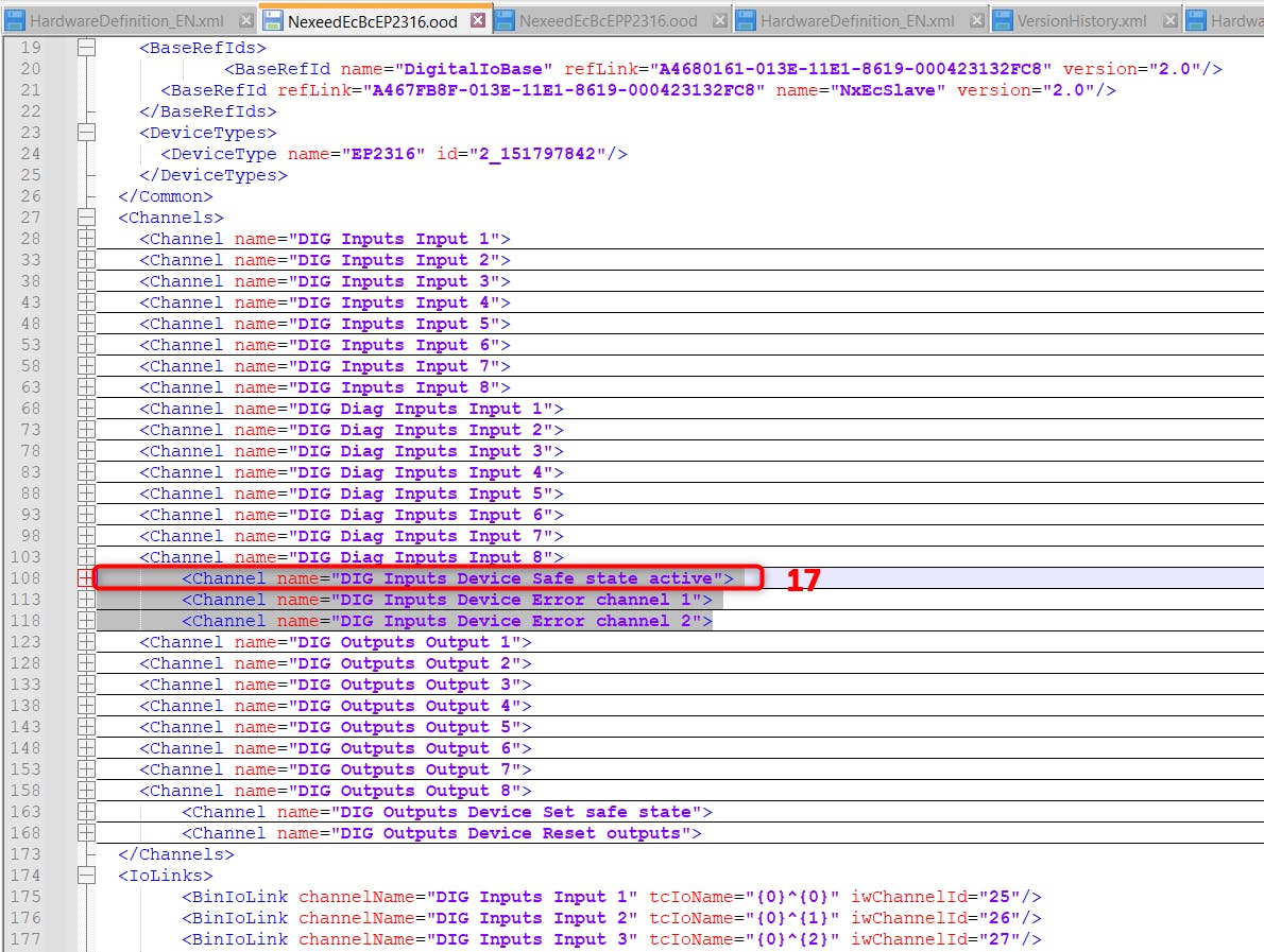

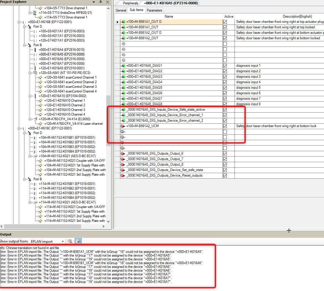

When I tried to import an EP2316 box to OES from ePLAN (AML or PHD), there is always an error acurred by assignning Outputs to IO (see pic below). I checked the ood file in the Peripheral. I think the problem is: the order of channels in ood file is different with ePLAN. In ePLAN the first output is at channel 17 (after 8 Inputs and 8 Diad Inputs), bu in the ood file it started at channel 20 (see the 2nd picture below). It makes misslocation when I try to import IOs. Can you fix this? Thanks
