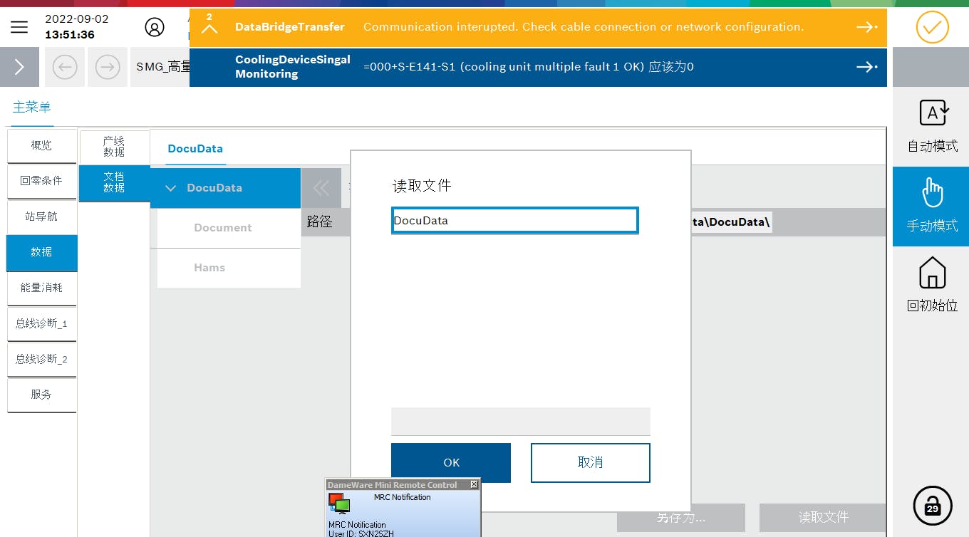

I met an issue when i try to change the storage path for data access. In my project, VPB40 and hot-plug mPad are used. There are two ethernet adapter on VPB40, C Lan uses IP '10.172.10.120', S Lan uses IP  '192.168.212.33'.

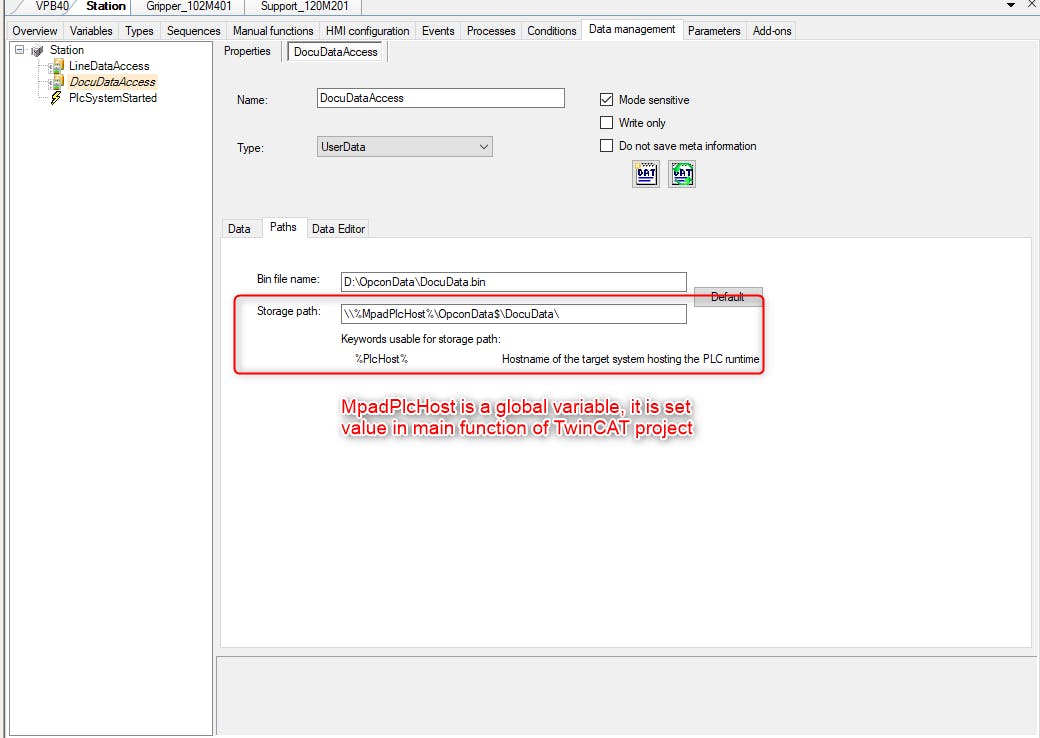

The default data storage path is '\\%PlcHost%\OpconData$\DocuData\',  PlcHost is set as 10.172.10.120.

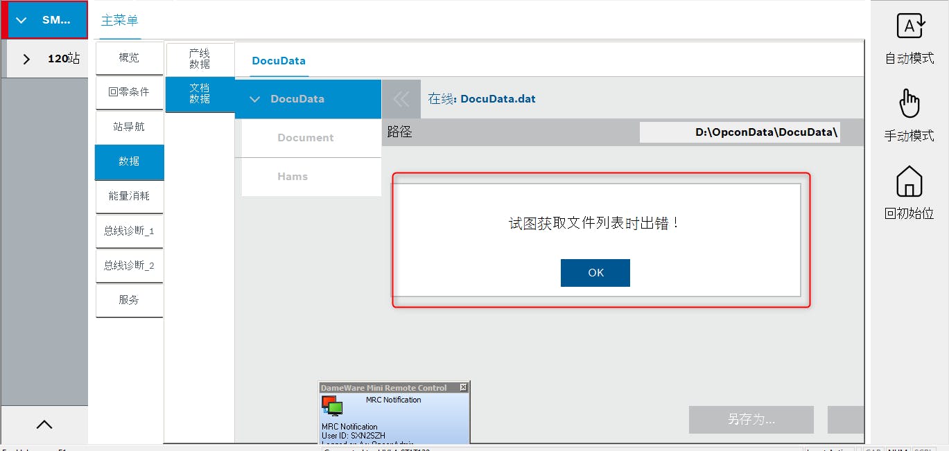

Since there is a hot plug mPad in this project and mPad is connected to S Lan, both HMI on mPad and VPB40 have to get access to OpconData folder. If i set storage path to be '\\%PlcHost%\OpconData$\DocuData\', HMI on mPad could not get access to the data folder. Thus, i tried to define a global variable MpadPlcHost which is initialized in Plc main function with '192.168.212.33'. At the same time, i change the storage path to be '\\%MpadPlcHost%\OpconData$\DocuData\'. However, neither HMI on VPB40 nor mPad could not get access to Data folder.
After that i tried to replace the storage path to be ' '\\192.168.212.33\OpconData$\DocuData\'',  both HMI on VPB40 and mPad have access to data folder.
My question, why it did not work with the storage path '\\%MpadPlcHost%\OpconData$\DocuData\'?
