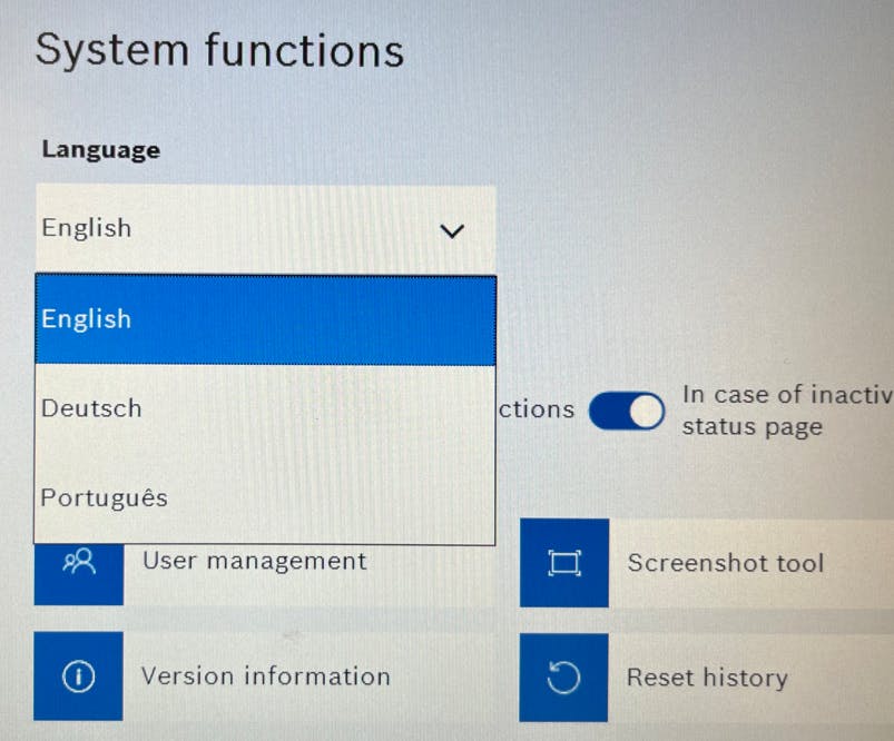

Is there a possiblity to change the order for the language selection on the HMI permanently?

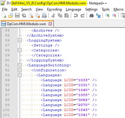

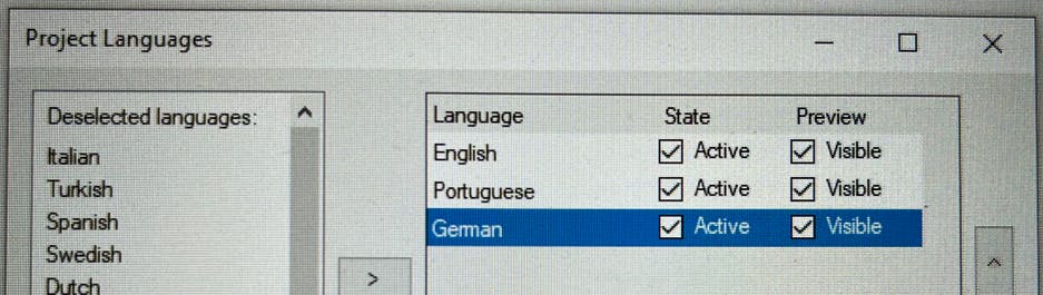

The language order in the CpS (5.8.2) project seems to have no influence, I have to modify the order of the languages in the LanguageSwitching section of the \Std\Hmi_V5_8\Config\OpCon.HMI.Modulo.vwn to be able to change the order
However if I update the HMI to a new version the change will be lost.- Would it be possible to make the order of the CpS project languages also be used for the HMI?
