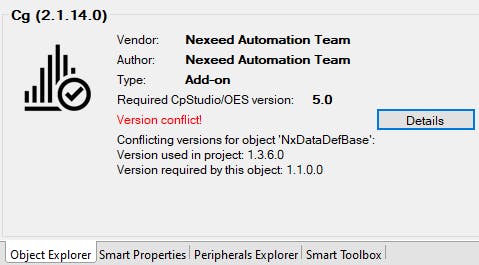

I have a machine that needs a CG mode and from what I've seen, Nexeed already provides an object to make it easier (CG addon and probe).

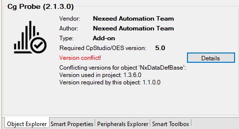

When I try to add it to my project, I get the "Version Conflict" error:
I've tried adding the V1.1.0.0 object but other objects depend on the V1.3.6.0 NxDataDefBase object.
My CPS version is V5.6.2.
Thank you in advance.

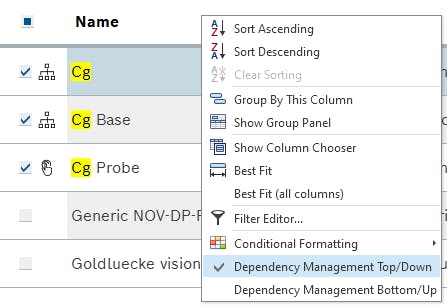

Update your Std with the Object Browser using the dependency management to automatically get all updates of the base objects:
Probably you are missing this update of the NexeedCgBase:
