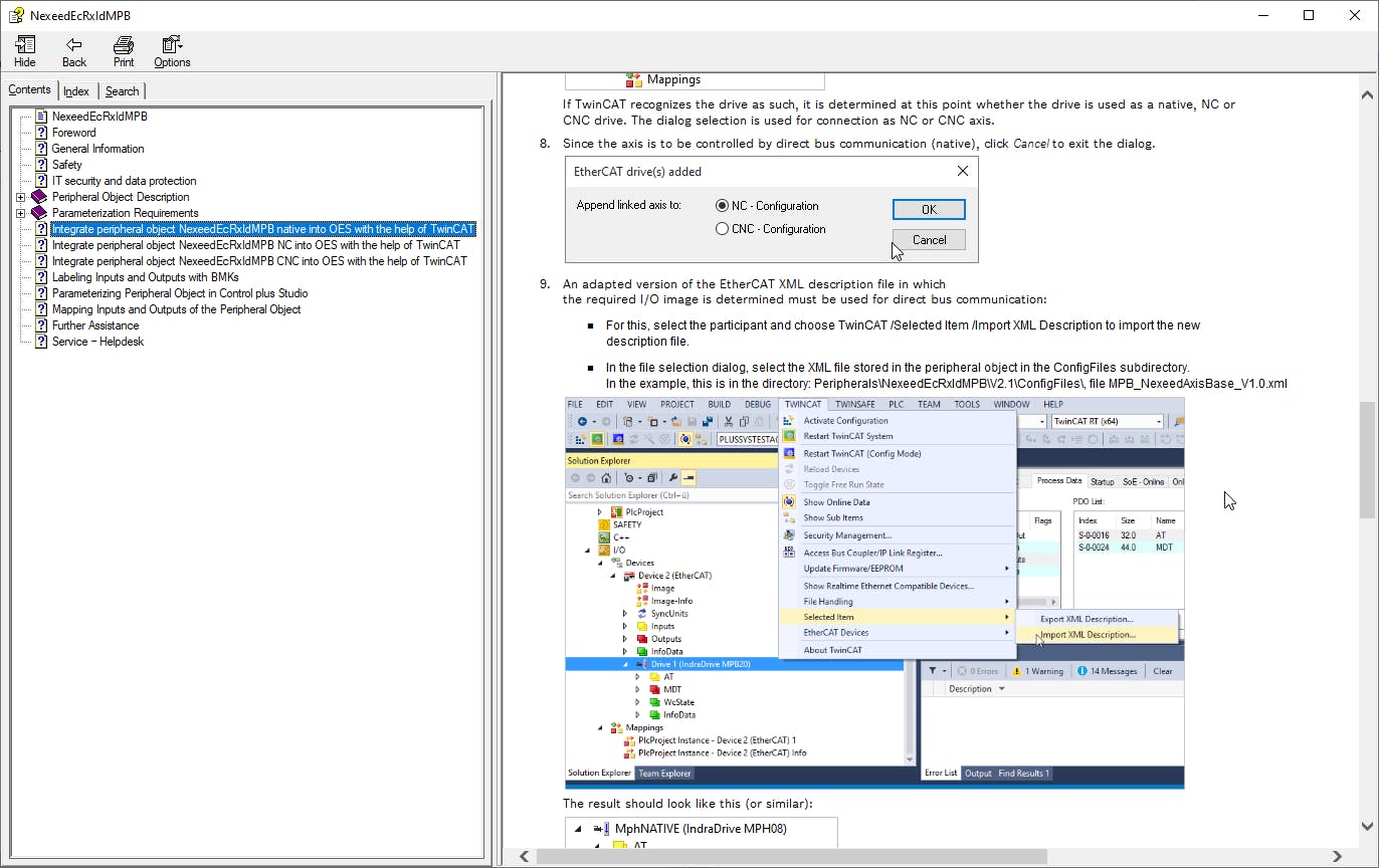

Best reply by Thorsten_Brach
Did you import the XML file as described in the documentation ?
