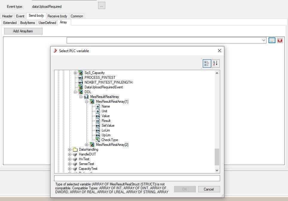

Array of (Struct) not compatible in Send Body of a DDL Event
Does anybody know why i can not add an Array of Struct in the send body of a dataUploadRequired?
The project is running in OES V4.8, DDL Event 2.2.3.0,  OpconTcpDdl 1.0.30.0.
I have upgraded to OES4.9 and update of objects DDL Event to 2.3.7.0, OpconTcpDdl to NxIpDdl 1.1.16.0 but i am still having the compatibility problem.
Looks like you have selected the old OpCon Xml spec V1, which does not support struct arrays.
  • Open View --> Data by category in the main menu
  • Double-click Data management
  • Select OpCon Xml Specification V2.x
