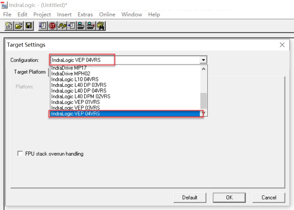

I currently need a target for VEP30.5. I tried to search for it in the Control classic download center, but I couldn't find it.
At present, I only have a VEP 04VRS Target that can be used as a project PLC, but I am not sure if it can be applied to VEP30.5?

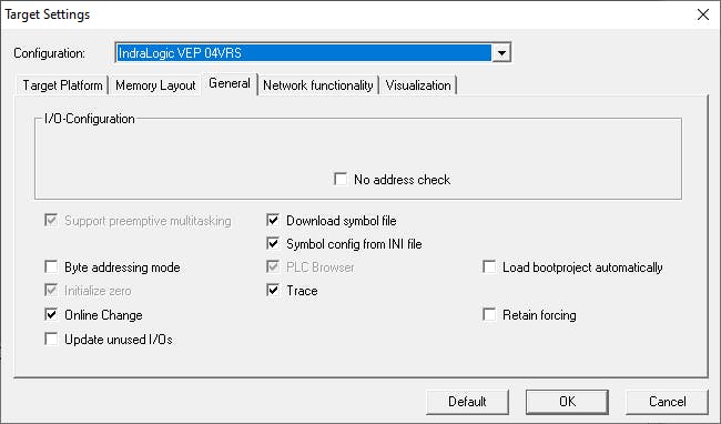

A VEP30.5 works with an Indralogic Runtime 04VRS. On the development computer, in order to transfer the program, the appropriate target system must be set.
In this case 04VRS. The target systems which are known to Indralogic on the development computer are all installed during the installation of Indralogic, if one answers the question for the installation of the target systems with YES.
Only the VEP30.2 has used a runtime 01VRS. Since VEP30.3 all VEP systems run with 04VRS.
It is important to set the option as shown in the screenshot
