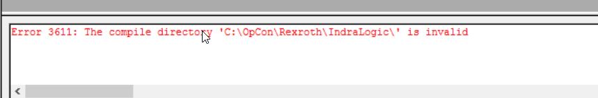

I have installed IndraLogic on a VM, and when I want to build I get the error from the picture? Do you know what can be the problem?

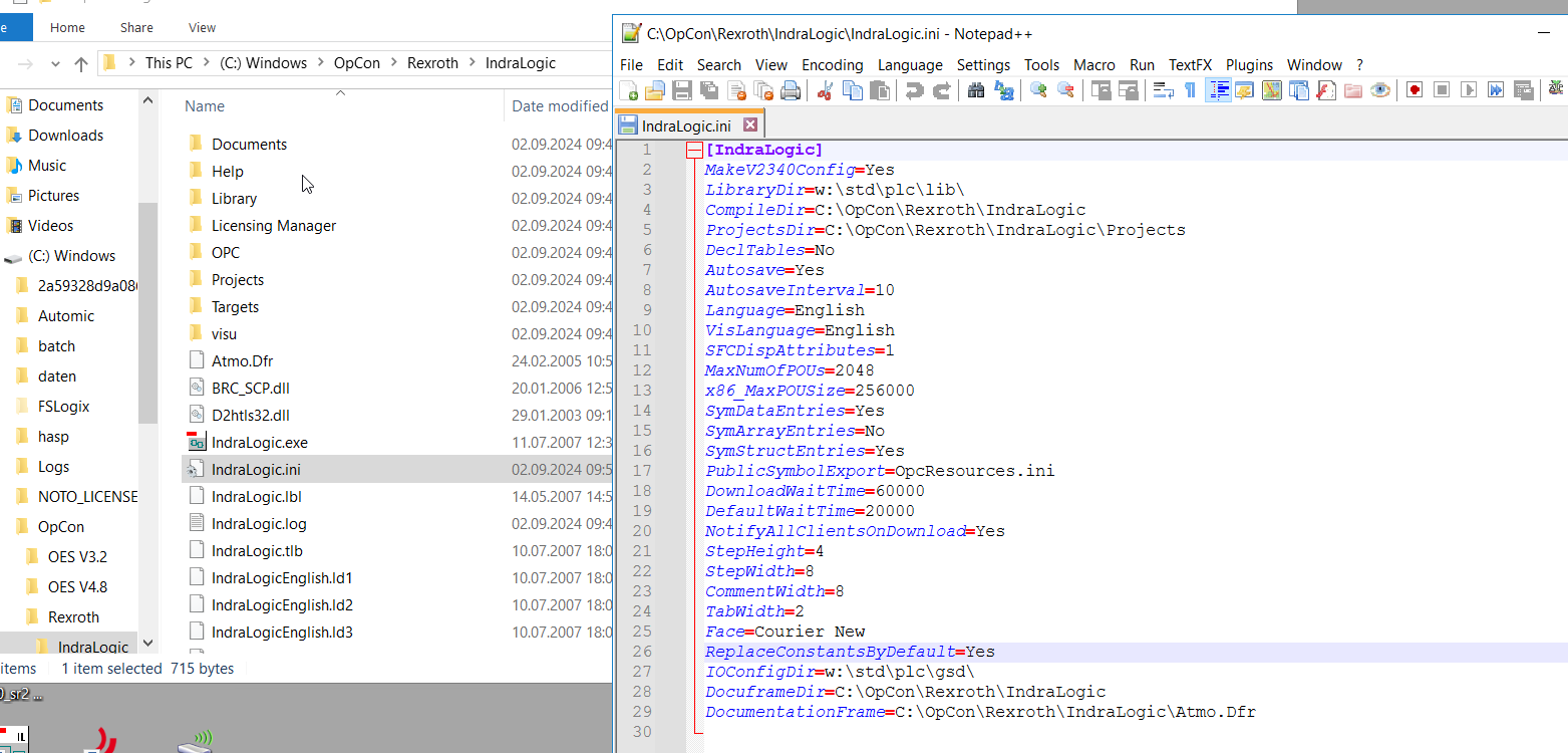

I think the problem is, that Indralogic can not access the path without Admin-Rights
Was Indralogic started as Admin, as you tried to build again ?
