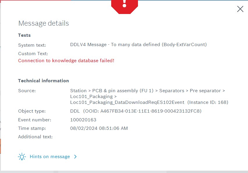

Is it possible to append the error text to the error messages related to insufficient memory allocations, for example:

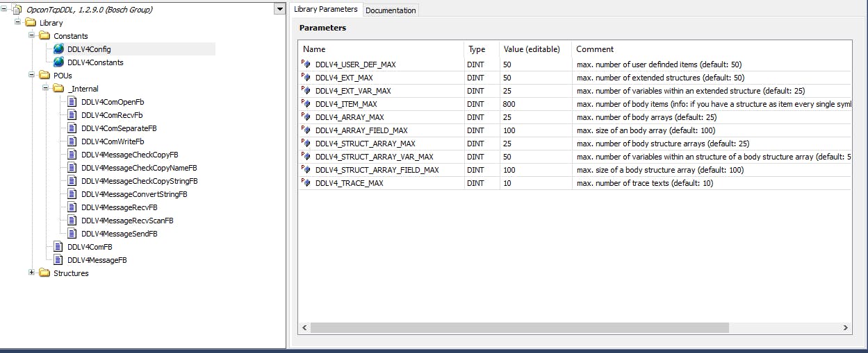

"DDLV4 Message - To many data defined (Body-ExtVarCount) - Check Constant OpconTcpDDL.DDLV4Config.DDLV4_EXT_VAR_MAX!"
We have some times this issue, that we have to increes the DDLV4Config-Konstants within the MES@AE Object. The users can not find out, is it a DDLV4Config or a MES@AE configuration.
For the next Version of MES@Ae 1.2 we implement a telegramm where we need to update this value at any time! So is ist possible to increase this constant also to 50 as default?
